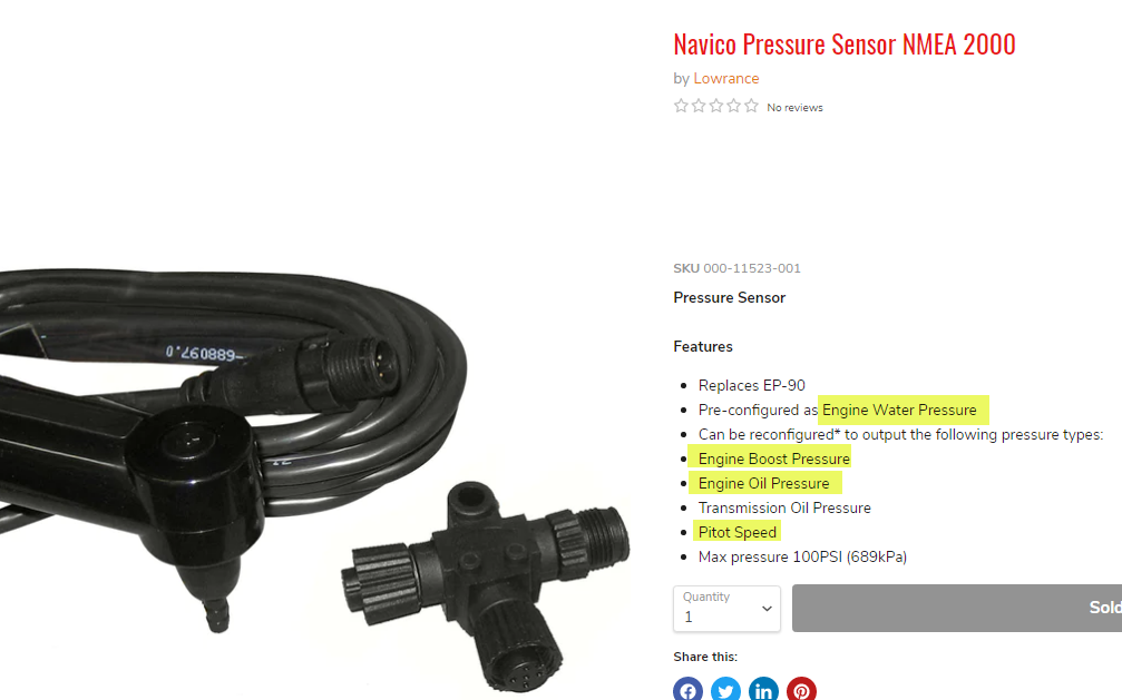

The F115 series of motors do not use an oil pressure sensor. It uses an oil pressure switch only.
Yamaha EFI four strokes use a manifold pressure sensor to determine fuel scheduling requirements. Sometimes shown on some MFD's as "boost" pressure. Why? I have not a clue.
Other sensors can be added to the motor in which case data therefrom may be available. Water pressure and water speed for instance.

I will check to see if I have a Boost display option - I may have seen it but figured it related to turbo or super charged engines.
