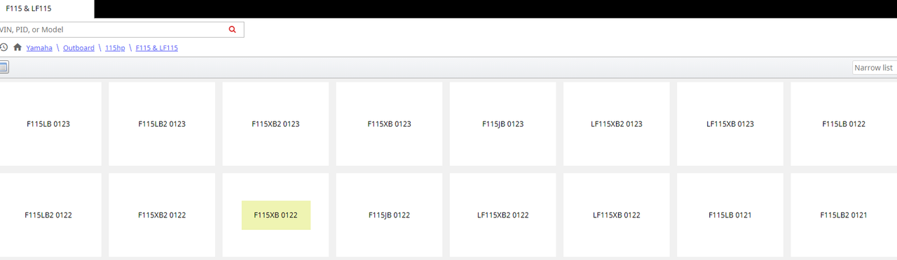

My Key West 179 FS/Yamaha 115 was rigged with Yamaha Command Link (115 is not CL+ capable) components - there are no gauges, just the two displays:
- Yamaha engine cable to Yamaha Hub (6Y8-81920-01 - photo)
- Yamaha cable to Yamaha Gateway
- Yamaha gateway (6YG-8A200-11 6YGA1064270 - photo) to NMEA 2000 backbone - photo).
I get graphic presentations on both Garmin displays (see photos) in two screens (must select the second):
- Screen One - rpm, fuel available, fuel flow, engine tilt
- Screen Two - battery voltage, engine water temperature
I get numbers offerings of about two dozen parameters in the presentation of rpm, engine fuel rate, as well, but the only data that shows with engine running is the same temp and fuel flow (see photos).
