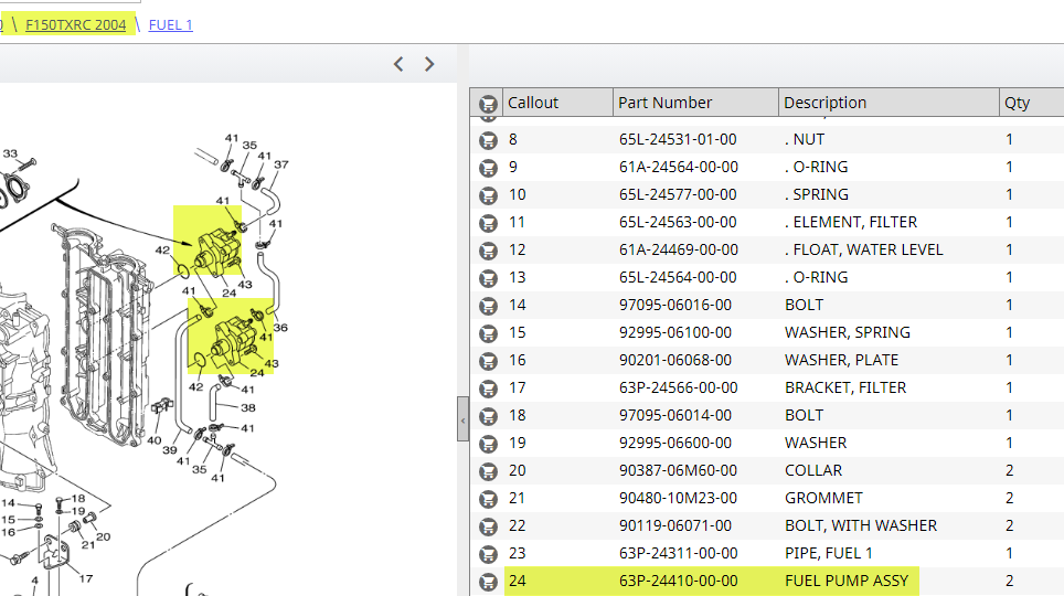

    Hi all, hoping an expert can answer this. The diagrams tell me my pumps are 63P-24410-20-00.
    When I search I see cheaper pumps #s 63P-24410-10-00, as well as 63P-24410-00-00. Is there a difference in these? That look the same and the ones on my model diagram are of course the most expensive by 2. Please no “ just buy what SIM has on the website “ , I want real advice based on technical knowledge. Thanks

              It’s a 2004 F150 xtrc.

                  very strange that that part number is not what I see here
                  Yamaha Outboard 150HP OEM Parts Diagram for Fuel Injection Pump 1 | Boats.net
                  63P-13907-00-00
                  never mind, you are looking for the lift pump not the injection pump
                  Yamaha Outboard 150HP OEM Parts Diagram for Fuel 1 | Boats.net
                  seems your motor used the 63P-24410-00-00
                  what diagram were you looking at?
                    That’s the confusion in part (no pun intended). Last week I ordered the 63p-24410-20-00, as per the SIM diagram for my model. That is indeed what the 2 pumps looks like, they are in series one above the other. This weekend I went to change it and saw there are 2, which I hadn’t seen before -my fault- and suddenly the diagram had a different looking pump under “Fuel”- with no Fuel 1 and Fuel 2. I will call SIM but I want to know, are all these similar looking pumps with very similar numbers the same pump? I know many manufacturers will set prices based on demand and change the number slightly to make an extra buck. Thanks for your help
                      Boscoe has a better handle on the number stuff, but the 00 would be the original part number and then the 10 and 20 would be the newer and improved versions of that part.
                      what was changed, we have no idea

                          He is talking about the mechanical fuel pumps.
                              An F150TXRC was delivered with 63P-2410-00-00 fuel pumps. See above diagram.
                              63P-24410-00-00 has been superceded by 63P-24410-10-00 and then by 63P-24410-20-00.
                              Buy whatever pump you wish. Many will use non OEM fuel pumps.
