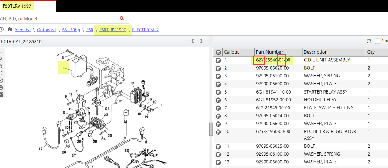

You said it was an F50. The photo of the CDI shows a 62Y marking. Which tells me it is for an F50 because that is the prefix for F50's of that vintage.
The -01 after the 62Y is telling us the dash number of the CDI. This all agrees with the Yamaha parts catalog. See below.
The 405854 is the serial number for the motor. A cheat sheet I have tells me that serial was assigned to an F50TLRV model.
