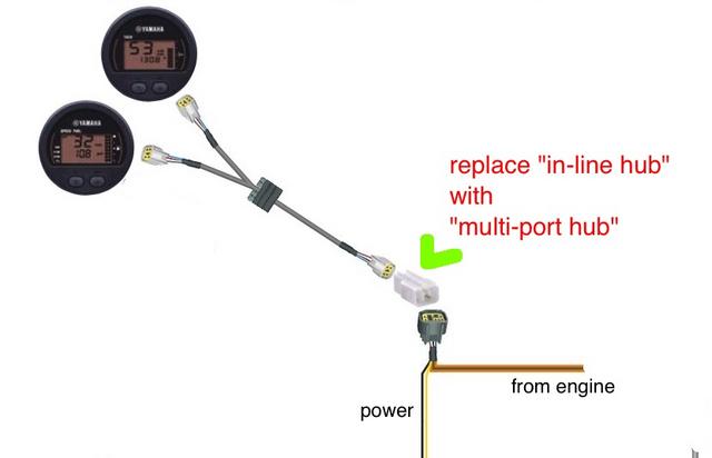

you need to connect the Echomap's NMEA 2000 port to your Yamaha gauge wiring,
and exactly how,
depends on how the Yamaha gauges are connected:
it may be that the two gauges are plugged into a "inline hub" using a "Y-cable"
as illustrated here:
if so, you purchase a Yamaha "multihub" Yamaha part # 6Y8-81920-01-00
and swap that, for the inline hub;
there will then be an available "DEVICE" port on the multihub
where you can connect an "adapter cable"
the other end of which will connect to the Garmin like so:

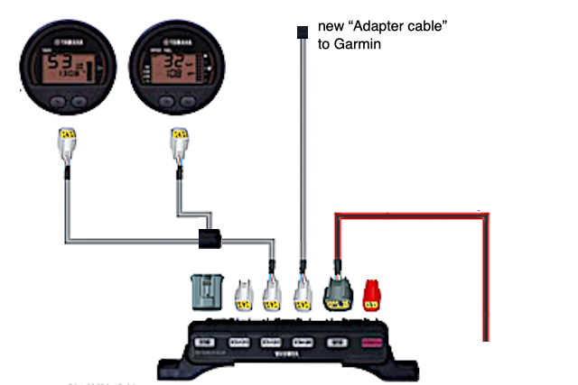

Of course if you already HAVE a multi-hub, not an inline hub -
then you just need the Yamaha -to-NMEA 2000 adapter cable;
a good choice is the Raymarine E70242
or Oceanic 3861-F
