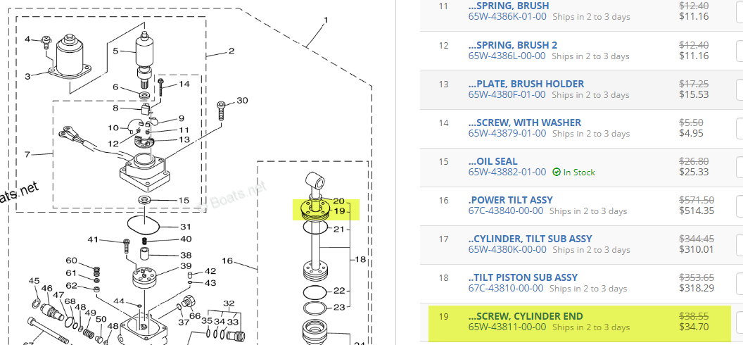

Okay, my end cap is dust. So corroded that it will never work again. Boats.net only has 67C-43810-01-00 TILT PISTON SUB ASSY (Yamaha) $318.29. That is the whole thing piston and all, and it is not available till September 20, 2021. No one seems to sell just an End Cap. Please someone tell me something that I don't know. Help me locate an End Cap. Thanks in advance.
Where to Find an F40TLRA Tilt Piston End Cap???? Just the CAP...
If you start again on boats.net by
search for that part # 67C-43810-01-00
and select it -
in the bottom right corner of the page is a list: "Related Fitment"
- all the engine models that use that exact same assembly.
Select a newer model from that list,
then go to the "Power Trim & Tilt Assy" page for that model -
and I think you will find a listing that breaks out the individual parts -
might take several tries -
since the entire assembly is the same as for your model,
its certain that the individual parts will be compatible with yours
Wonderful... Just ordered the part from boats.net for $47.69. It says it will ship on Monday. I canceled the other order for the full assembly. You just put $300 back in my pocket. Thank you very much.
