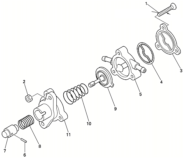

            But, a pressure and vacuum check on the mechanical fuel pump showed it would not hold pressure or vacuum. I removed from engine and tested again and could hear air sounds on the end where the camshaft drives the pump shaft. Removing the cover and shaft revealed a diaphragm that looked dry rotted and a floating fragment of rubber that had come loose.
            So, for now I'm figuring the compromised pump was putting gas in the head and diluting the oil.
            I have ordered a replacement pump, O-ring, thermostat and seal, new oil, oil filter and both new fuel filters.
            Thanks,
              It was a bad diaphram in the fuel pump. The mechanical lift pump runs off the camshaft. If the diaphragm goes bad, it can dump gas right into the crankcase. The thermostat also looked pretty ragged, so I replaced it, too. But that wouldn't explain the poor idling or the huge amount of gas showing up in the oil. The bad diaphragm does. It didn't have large holes in it, but looked dry rotted and a small chunk had peeled off. So it would send some gas to the injectors and dump a lot in the crankcase it appears. You can see where the pump goes through the valve cover and is driven by the camshaft. A perfect entry into the crankcase.
