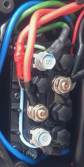

I own a Yamaha 4 stroke, 75 hp, 2009 outboard and the TT quit working tonight. When i push up or down on the shift lever TT button or the one on the engine I just heat a single click each time I push the button. Does anyone know how what is wrong and how I can fix it. Thank you in advance for reading my post and hopefully, telling me how to fix this.
I cant find out where to post a new question
Originally posted by okeechobee View PostI cant find out where to post a new question
If you are getting the same click both at the remote control switch,
and the 'trailer switch',
then both switches are likely good.
If you are getting a click - but just a click -
for both up and down,
that's the sound of the relays actuating;
but since they are two separate relays,
that likely means the relays are OK
but the motor is bad.
The relay is on the front of the motor,
starboard side, under a plastic cover,
near the bottom.
The big red wires are unfused direct battery power -
so you may want to switch off, or disconnect the battery + cable
before you start messing with it.
The big blue and the big green wire are the t/t motor leads
if you remove them from the posts of the relay,
you can know that you are testing the motor directly:
connect one (either blue or green) to battery (+),
the other to battery (-)
the motor should run.
