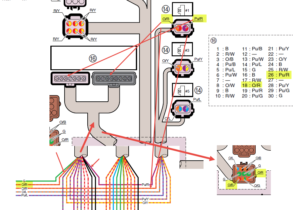

Hi everyone! new to the forum. A great place for info! I have a 2008 VZ200RTLR with 314 hours on it. I have an irregular injector signal code. I do have the YDS and I have it pin pointed to injector number one. I run the static test on the injectors and all but the #1 injector work (#1 does not pulsate during the static test). I have placed the injector #1 connector to injector #3 and ran the static test again and injector #3 will no work (same results as when connected to #1). I was able to connect the #3 injector connector to #1 and ran the test and it worked as it should. Now the problem is sporadic and it is usually a problem at first start and may last a short while, it would drop in and out at times, then the motors would work fine, both when used on the water or on the hose. When the code pops up the engine runs at higher rpms and I lose power (obviously due to the #1 injector failing). I have done the following service to the motor, some items were done as regular maintenance
