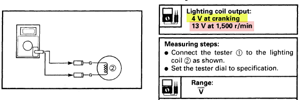

    scan200 001.jpg I'm looking for the specifications for the lighting coil for my 1998 outboard 25ELRW. My shop manual does not have it as shown on attachment. the part # is GL2-85533-10-00. I'm also wondering if there is a different lighting coil that would work in it's place since this coil will cost me about $200 by the time I pay shipping and tax. Similar lighting coils that look the same cost about 1/3 rd the price. I understand this coil charges the battery, but I ran the boat the last month of the season and the battery held it's charge. Do you thing I need it? Thanks Bill

    looks like your manual is not for your motor
      shop manual 001.jpg starting motor-bilge pump-depth finder.-- motor also starts easily with rope pull. I can charge it when necessary with remote charger. Manual covers my engine quite extensively but I'm not finding this information. Thanks Bill
        that is an aftermarket manual.
        might look around for one from Yamaha that is for your motor.
