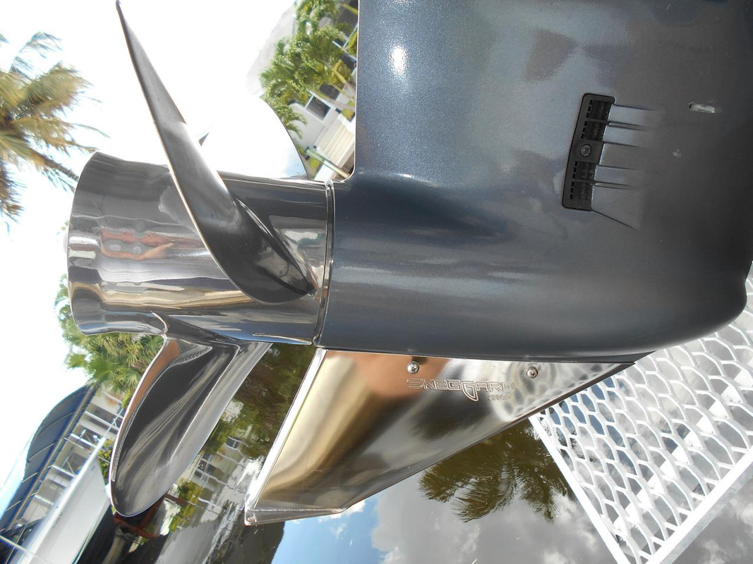

I'm assuming I should put a skeg guard on this? Any brand in particular?

Plus 1 re Pan's note. Prep/clean the skeg before doing anything with it.
When I installed mine, I re-painted all the scruffs (soft sand run aground, no corrosion). I then waxed the heck out of it before the install.
As noted, there are only two bolts that secure it and are designed if you hit something super hard, they should shear off,
it'd protect the original skeg((what's left of it)) and LU.
Fresh water runs down into there whenever the engine is washed as well.
You also have the option of epoxying it on there. That would eliminate any corrosion/water intrusion.
Click on the link. I had mine custom made and the customer service was EXCELLENT. He's a one man operation(at least when I ordered probably 5 years ago)
The drain (so water drains from the unit) is usually on the front. I wanted it on the rear as I store mine on a boat lift/engine trimmed fully down.
It would drain better and won't clog with dirt if run aground(hole at the front). I had to wait a couple weeks but the owner made it specifically for me with NO payment. (That drain hole is drilled BEFORE the SS is bent/welded up).
The only down side, I lost 1 MPH on the top end (a little more drag).
BTW, our engines are mostly aluminum, held together with mostly SS hardware.
