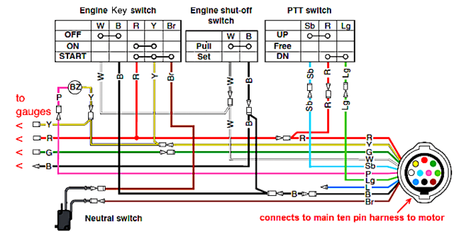

    New here need help. I bought a 90hp 2stroke (i may have been jipped thinking it's a 85hp but no biggie). I stripped it down bare and changed everything (only kept the power head) it was in bad condition. But I'm getting it back together now and it runs. My problem is my key switch doesn't work sometimes. When this happens, If I use a rope around the flywheel and start the motor it runs and shuts off from key or kill switch....then it may start from key........
    Now a history on how I think the problem started.....
    Thing is I had trim n tilt problems from switch. It would only trim down was getting a 'click' when i tryto trim up....after replacing relay (brand new) i had the same problem. Baffled I opened my control box (also brand new) I realized one of the screws that holds the box together went straight through the blue (trim up) wire ‍♂️......I repaired the wire but now when I try to trim I get a 'click' and key switch goes out.
    It feel weird even trying to explain. But can it be the trim switch is bad or has a short? Or did the screw through the trim wire cause the key switch to have a short? Any help or point in the right direction is GREATLY APPRECIATED! I am at a dead end on what to try next before I go buying more parts. I need to know what to buy‍♂️

        testing voltages to and out of the key switch will tell if the switch works or not

            I tried something today... while the engine was running, the key bumps the starter just fine with no hiccups (I know im grinding the teeth but i had to try it and it works while its running). How can I test the voltages in and out of the key switch (which wires)?
                the red wire brings 12v+ from the motor
                when the keyswitch is 'on', it connects that power to yellow
                'start' connects it to brown, which has to pass through the neutral switch
                to get back to the motor
                the trim switch connects it to blue or green

                      Thank you all soooo much for your help. Did everything you all said....everything tested out just fine. Fully charged and load tested the battery, checked voltage to and from key switch, and trim switch, checked all connections.....everything was just as it should be. Decided to start rewiring the engine and I'm ashamed to say but i found a ground wire not screwed down tightly to the engine (the main harness ground wire) it was cross-threaded so it could not torque down. Changed it and everything works 100% now. I feel soooooo foolish now lol but i knew it had to be something simple. Had it now been for you all helping I probably would not have found it. So thank you again, definitely will be back with more questions lol. This is my first boat so I'm new to it all but learning so much. Thank you thank you thank you!
