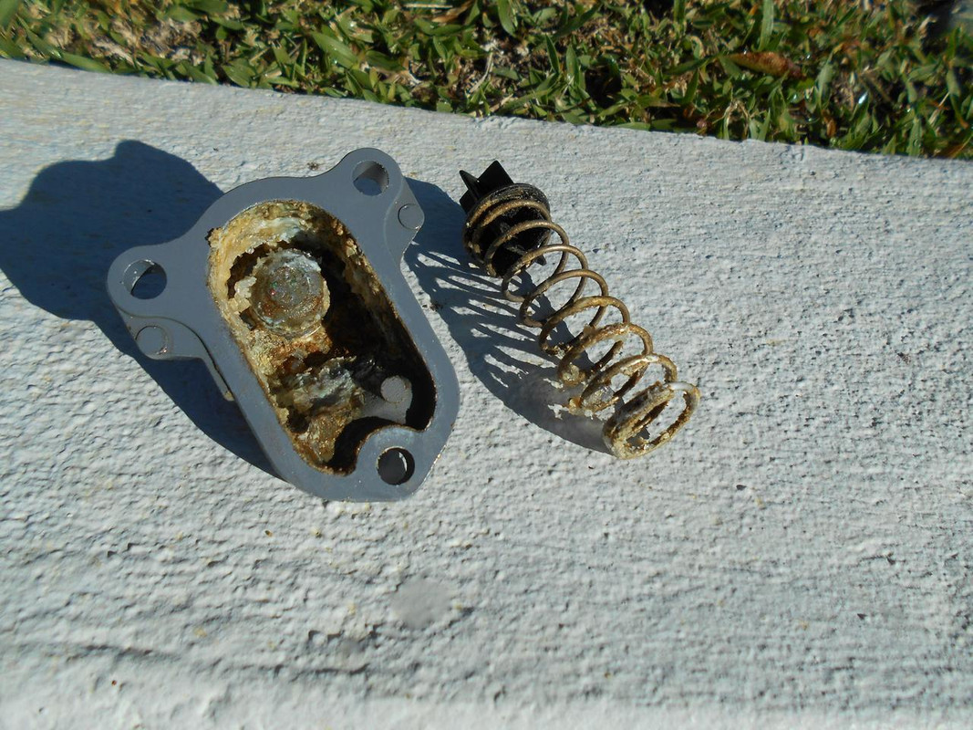

          My 2006 F150, with about 10 years on the engine:
          Three major anodes:
          PCV valve/cover
