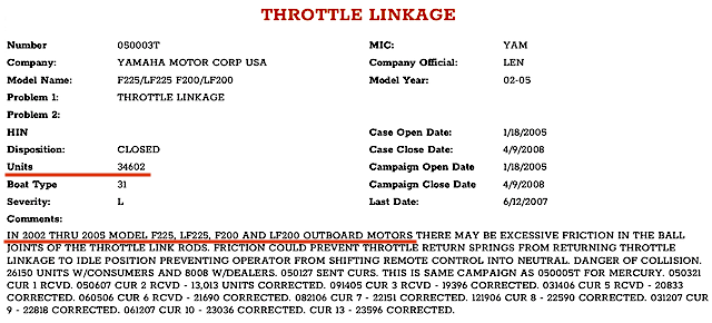

I just recently noticed,
in the USCG records of the throttle mechanism of the early 3.3 F200/225
a number provided by Yamaha for "units affected"
which I interpret as,
the entire US distribution of 2002 through 2005 model F200/F225 engines
Good point fairwind.
Of the 34,602 let's say 10% fail. I doubt it is that many.
Of the 10% (3,460), 10% of those (346) get on the innerweb and complain over and over again about how life is so unfair. People that have never owned a Yamaha of any type then get on the band wagon and repeat over and over again how they have heard about the dreaded Yamaha F225 corrosion issue.
Makes the problem appear to be much much worse than it actually is.
