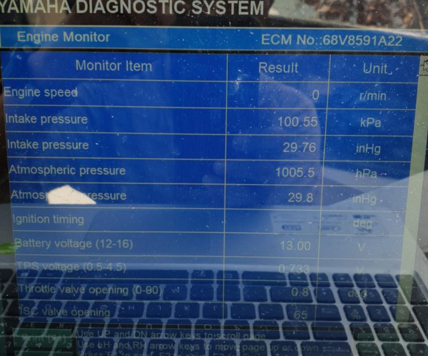

    Here is my diagnostics test results...anyone willing to analyse if all sensors are within specs?Have not test it on the water yet.

        These are the values at engine off.....is my link & synch done correctly?the valve opening is at 0.8 degree at engine off.

              Some times Rod says he cannot open thumbnails so I am enlarging the pic to make sure he can see it.
              also I thought the ISC was suppose to go to 100% when shut down, but I have no idea how the screen should look with engine off. 65% has me wondering
