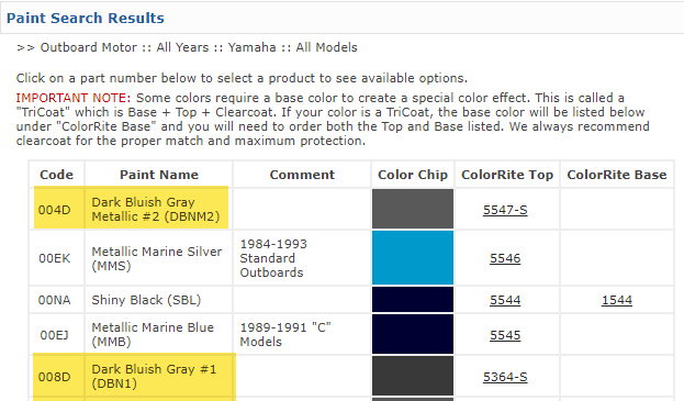

          Looking at the part numbers again I am wondering, is there a difference between the '4D' and the '8D' tiller assembly, because in the pictures they look identical.

              The last two characters denote the colour code or finish code. 4D and 8D being closely related.
                As I said earlier the -04 is an updated/upgraded -00. More than likely it is functionally the same.

                  boscoe99 , Thank you that is very valuable knowledge when purchasing any part. I agree with you the difference in colour does not upset me.
                  I'll review the pictures and schema's of the parts once more and will likely place the order.
