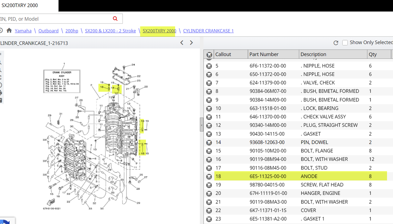

        Look in cylinder block diagram here. #18
        https://www.boats.net/catalog/yamaha...er-crankcase-1
          OK, so I think I've figured it out because I don't see anything resembling an anode. Appears you have to take off the water jacket to uncover the block ones and the cover plate on top of the block. Are there 4 per motor - 2 on top & 2 on the block? Do these guys have the same part number?
