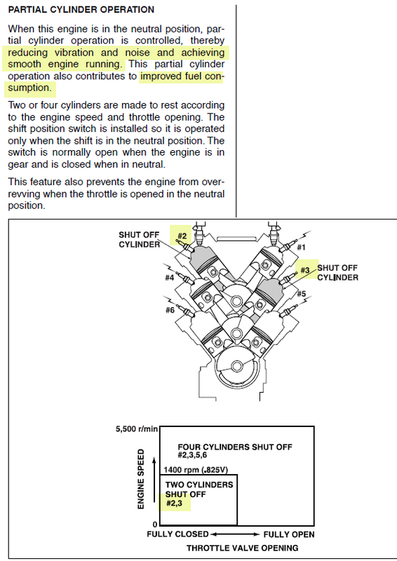

    HPDI motors do not fire those while in neutral
      As mentioned, they do not fire those plugs in neutral, if they never fire (even in gear) then the shift switch (on the motor end) is faulty or out of adjustment.
        So if I start it and put it in gear it should fire those cyl.

        Started it and tested spark in gear both 1 and 5 have spark.

            Figured out the 1/5 no fire. In gear they fire.
