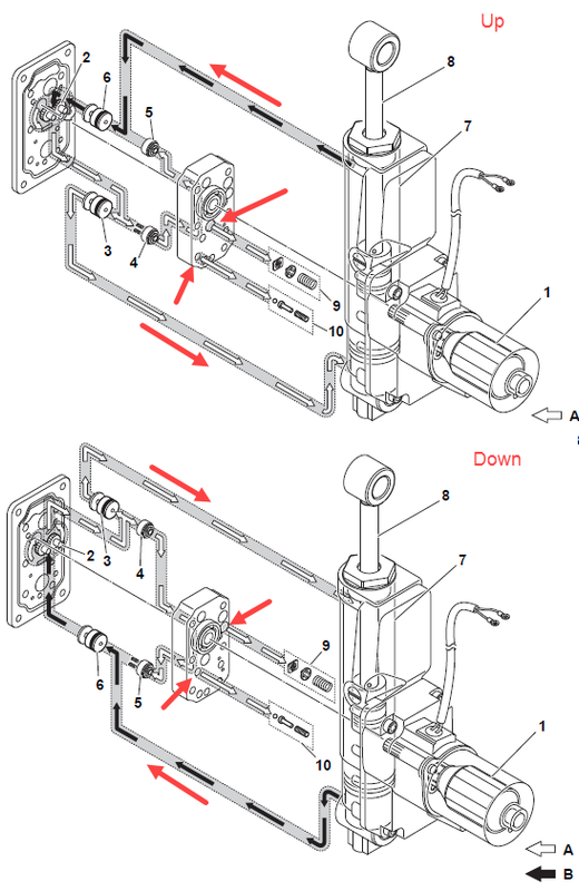

    I am very confused now, how can #9 be the up and down relief valve and open at different pressures depending on up or down direction?
    looking at it harder, it seems #9 up relief valve is not in the same position/ location as the #9 down relief valve,
    so it is not the same valve after all
    kind of confusing to me
    Trying to reply with diagrams but getting an unapproved message.
    • #17
      • #18
        Silly system is biased against illustrations.
        • #19
          • #20
            https://i.postimg.cc/6q8CsqNH/ports.png
            • #21
              As I said I see that the up and down are different valves, but they labeled them both #9 for some reason.
              it would have been better to label them with different numbers and had at least one diagram showing both at the same time.
              but I understand what we are seeing now

                Does seem strange.
                Authors find it difficult to remember how it was to be unknowing. They make way too many assumptions as to what their readers will see in their work
                • #23
                  Thanks for the drawings that is just what I needed when new parts arrive I can install them the correct way Thanks
                  • #24
                    All of the new part's arrived installed them in the tilt unit it works fine thanks for the help
