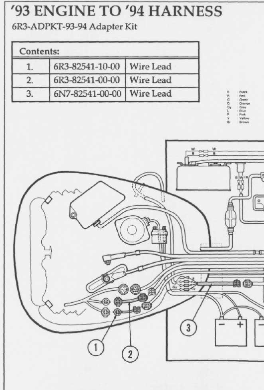

    I have two engines in my possession. The first one is a 130hp 1995 which is mounted on my boat. The other one is a 175hp 1993 which a bought as a non runner. Now the older engine is working and I’m about to swap on the boat. The problem is that the wiring harness was altered between -93 and -95 from round to square contacts and I’m not so keen on changing instruments and wiring harness on the boat.
    Is there any wiring adapters between the round and the square wiring?
    Is it easier to just change the wiring harness on the older engine? I’ve seen pretty cheap ones on eBay.

    The connector change was made for 1994 model year motors. 1993 and earlier used round connectors. 1994 and later used square connectors.
    Yes, there are adapter harnesses available.

      Thanks for the reply! Do you know any part numbers or where I can source the adapters?

        You can source them from this website. www.boats.net
          Excellent! Thanks! This made things a lot easier!
