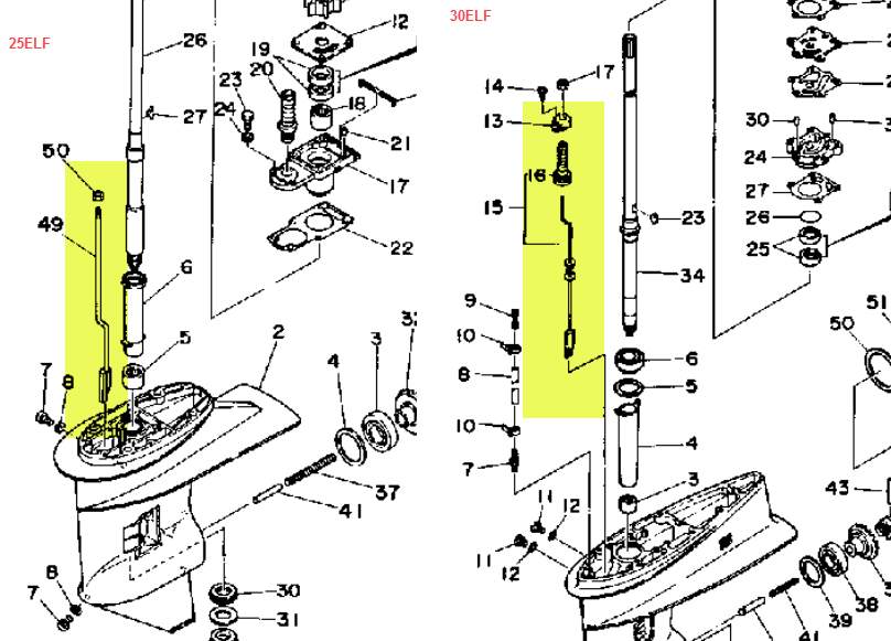

    I have a 1989 30 elf that has developed a crack in the lower unit housing adjacent to the water pump. It is leaking oil and it will be necessary to replace the lower unit housing or the entire lower unit. I ran across a post in this forum from someone else that was looking for a complete lower unit, and found like me, that lower units for this model are few and far between. He was advised by the super moderater that a lower unit from a 1997-2000 25 hp Yamaha would fit his 30 hp Yamaha. If that is true, lower units for a 25 hp are much easier to find than one for a 30 hp and that will make my search more expansive. In fact, I have found one but it is from a 1994, not a 1997. The 1994 has the same part number as a 1997 and it seems as though it will fit my engine. Both the 1997 and 1994 25 hp have the same part number (6l2-45311-02-4d), so I should be good to go. The only difference I can see from the parts diagram is that the lower unit from the 25 hp has an end cap rather than the big nut holding the rear bearing in place. That being the case, it may require a prop for a 25 hp, but I'm not sure.
    Can anyone tell me if the 25 hp lower unit will bolt on to my 30 ELF?

    Shift shaft configuration is different on the 25 and 30 HP models. Casing is different.
    I am guessing that a 25 gear case won't work on a 30.

            I'm sorry to tell you that i haven't found a solution yet. I think the ultimate is going to be a new engine. As far as i can tell, the lower unit on the 30 hp is unique and no other lower unit will fit. I may take my lower unit to the machine shop to see if they can save it, but i'm not optimistic. It's really disappointing because this has been one of the most dependable outboards i've ever owned. I put the key in it and it goes, every time.
            I looked into the chinese lower unit housings, but was not comfortable that they knew what they had. Because this lower unit housing seems to be so unique, i backed away from the aftermarket housing. As far as the housings from a 40 or 50 hp, i spent hours crossreferencing them until i was satisfied that they would not fit. As far as the 25 hp lower unit is concerned, i called the parts people at boats.net and they could not verify that a 25 hp unit would work. I also spoke to the local dealer and got the same answer.
