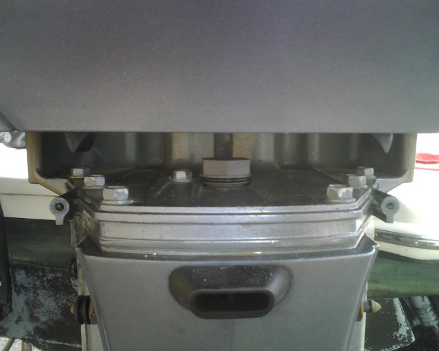

    Hi all. I have a 2014 F250 that will overheat at idle. After some reading, I hear the poppet vale could be the issue but the local Yamaha dealer says they cant locate a poppet valve on this engine. Is that correct? Could it be the impeller or thermostats? Thanks
    If you, in fact, have a 2014 F250 3.3L
    then the Pressure Control Valve ("poppet")
    is in the same place as any other 3.3L F200/225/250
