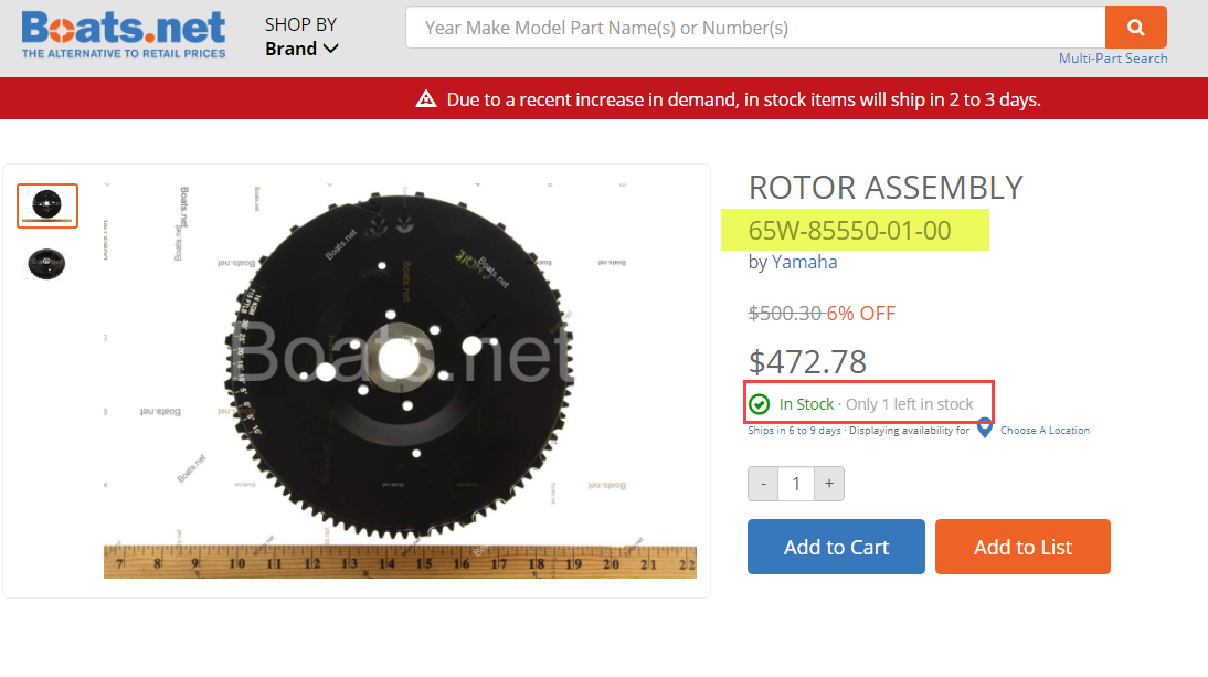

        When you say that Yamaha is backed up and does not have stock, are you referring to Yamaha Canada? Reason why I ask is because the company that runs this USA website says they have one in stock. If they don't, Yamaha USA has two of the 65W-85550-01-00 flywheels in stock.
          I have searched until I am blue in the face. I cannot confirm that 832010T32 and 65W-85550-01-00 are one and the same part. They may be. But...
