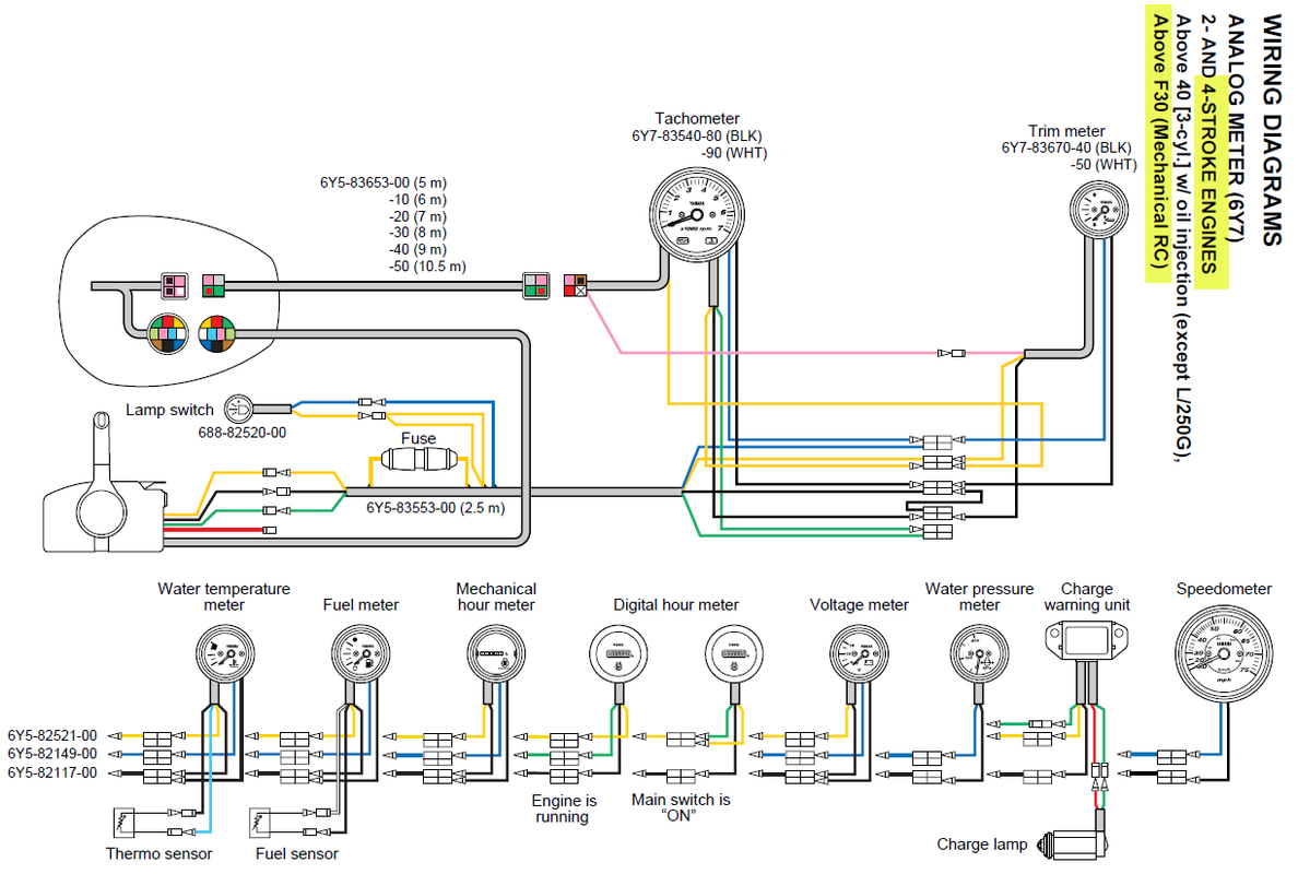

              Boscoe,
              What is a "charge warning unit"?
                Low voltage indicator. Like you find in some automobiles.
