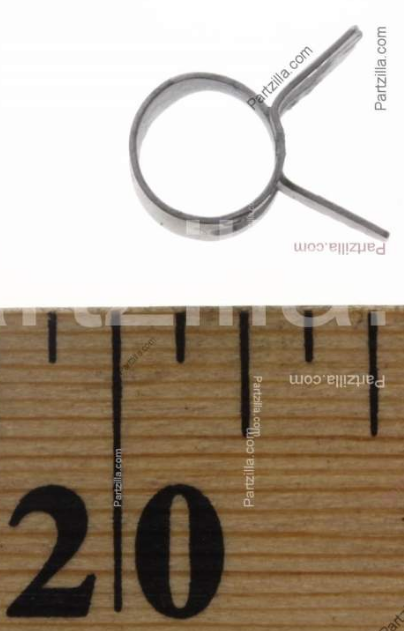

OMC used them for every connection for years . A little squeeze once in a while is good smarts. Oetiker are not over kill. I have never needed to use more then one The pic of the clamp above is a spring clamp
Not a Oetiker
